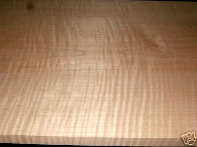

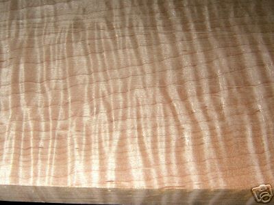

I went ahead and purchased two boards that are Super Curly Maple (soft).
The dimensions are:
41.75 X 10.25 X .875+
and
36.75 X 11 X .875+
Most Jumbo sides are sold around 5" wide if I'm not mistaken, so I should be able to saw in half (width wise) and get an extra set of sides per cut or use for neck laminates.

Steve, I've got the pictures from the ad so far, but I'll take more when they arrive and post those as well.

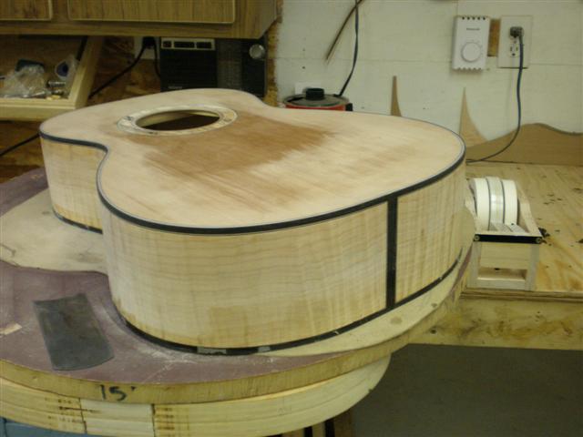

Blain, nice wood. That is really going to pop under finish. Soft maple will certainly be a fine choice. Of course try and use the quarter sawn sections for the back and sides rather than the flat sawn. Save the flat sawn sections for the neck laminations.
Use care when bending, this is considered by many builders to be one of the hardest woods to bend.
Have you thought of using western red cedar for the top. That will give you some nice warm tone and the look is really nice too.

PostPosted: Wed Aug 01, 2007 4:39 pm
Rod, is that ebony binding or something else that is stained black?
I *LOVE* the contrasting colors of the maple, WRC and what ever the black binding is !  WOOT WOOT
PostPosted: Wed Aug 01, 2007 5:39 pm
Ya Ken, it's ebony. Headstock veneer, FB and bridge will match it.
Blain, what do you have for a bender? I don't want to scare you off from using the maple. Remember that curly maple has been used for hundreds of years on all stringed instruments. You just have to be patient with it and you'll be fine. Supporting the wood on the backside of the bend will really help with bending.

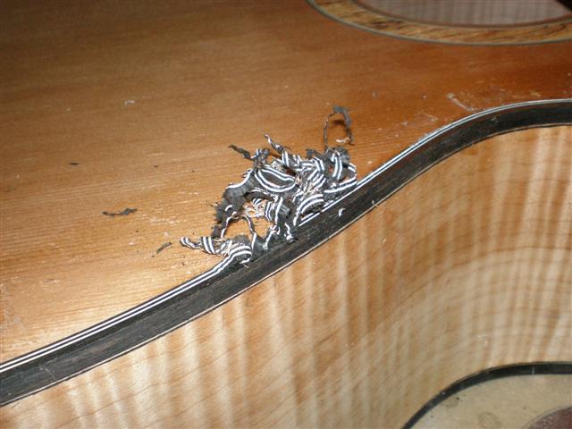

[QUOTE=Hesh1956] Rod your latest Geetar is looking fantastic my friend!!! I really like the high contract of the ebony and the purfing too. Nice work and great looking shavings too. [/QUOTE]
I really wish I could say I was working on it. That picture was taken back in December, last time I worked on it.
Thanks Billy.
Blain, sorry for the hijack on your thread, just wanted to show you a different look with the cedar.
